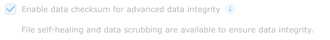

My “source of truth” has been my NAS. The SSDs in my Antipodes act as a backup destination. The NAS is configured to periodically perform “data scrubbing”, which looks for inconsistencies. But more importantly, this setting is enabled:
Self-healing is a nice option, but I still back up my music to two different drives. A while back, I also mailed a friend a drive with a copy of all my music as an offsite backup destination. I need to do that again.

I have always thought of my K50 as the ‘parent’ library and my NAS as the ‘child’, but this is a good reason to reconsider that relationship. I will have to check if my Synology software has a data-scrubbing feature. Are you using a configuration built into your NAS or is it something third-party?
Built in, but the partition is Btrfs. This is good:

Very helpful info. I set up the data scrubbing feature. Monthly is the most frequent that can be scheduled.
It looks like the checksum feature had to be set up when I first created the partition on the NAS. I am not sure I want to re-build the entire library to get that going, but self-healing would be a good thing, so I might have to take on that challenge.
