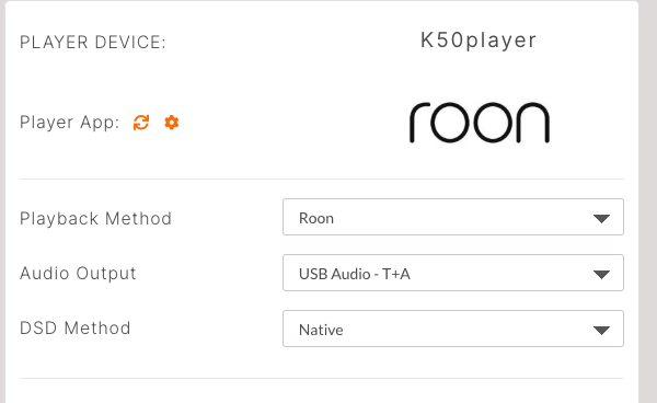

I agree, the DSD technology on the DAC 200 was also one of my purchasing decisions. However, there is also a ‘problem’ here. I had set the Oladra to ‘native’ as part of the setup so that I could listen to a few selected DSDs later. But there were immediate problems here. Only when I switched to DoP did the devices work well together. Of course, I can still play albums in DSD… But if I understand correctly, the DAC doesn’t play through the section made for it? Maybe that’s not true either?

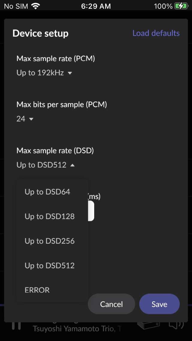

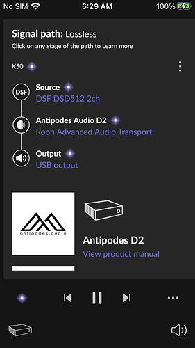

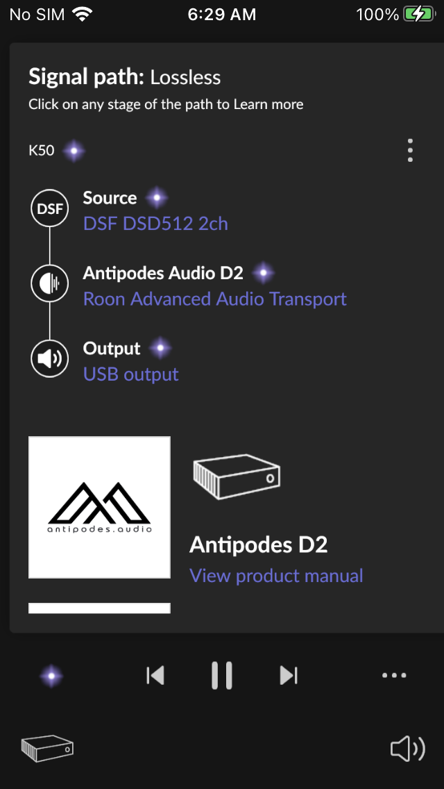

What software are you using to play back? With Roon I am currently playing DSD512 files with the DAC 200 into the K50 with native, but Roon is picky, and I do have some DSD files that don’t play. My limited understanding is as long as the file originated from a 44.1 base sample rate it works just fine. If you are using Roon, you have enabled the max sample rate?

I will add my two cents: you have not heard what this DAC is capable of if you haven’t yet fed it music properly scaled to DSD512. It takes it to a much higher level. Astonishingly so.
DSD64 has limitations so DSD get it’s bad wrap from that. DSD256 is where the magic begins to happen. The DAC 200 offers a pure path for DSD that so that’s another advantage. Transparency can be stunning.
