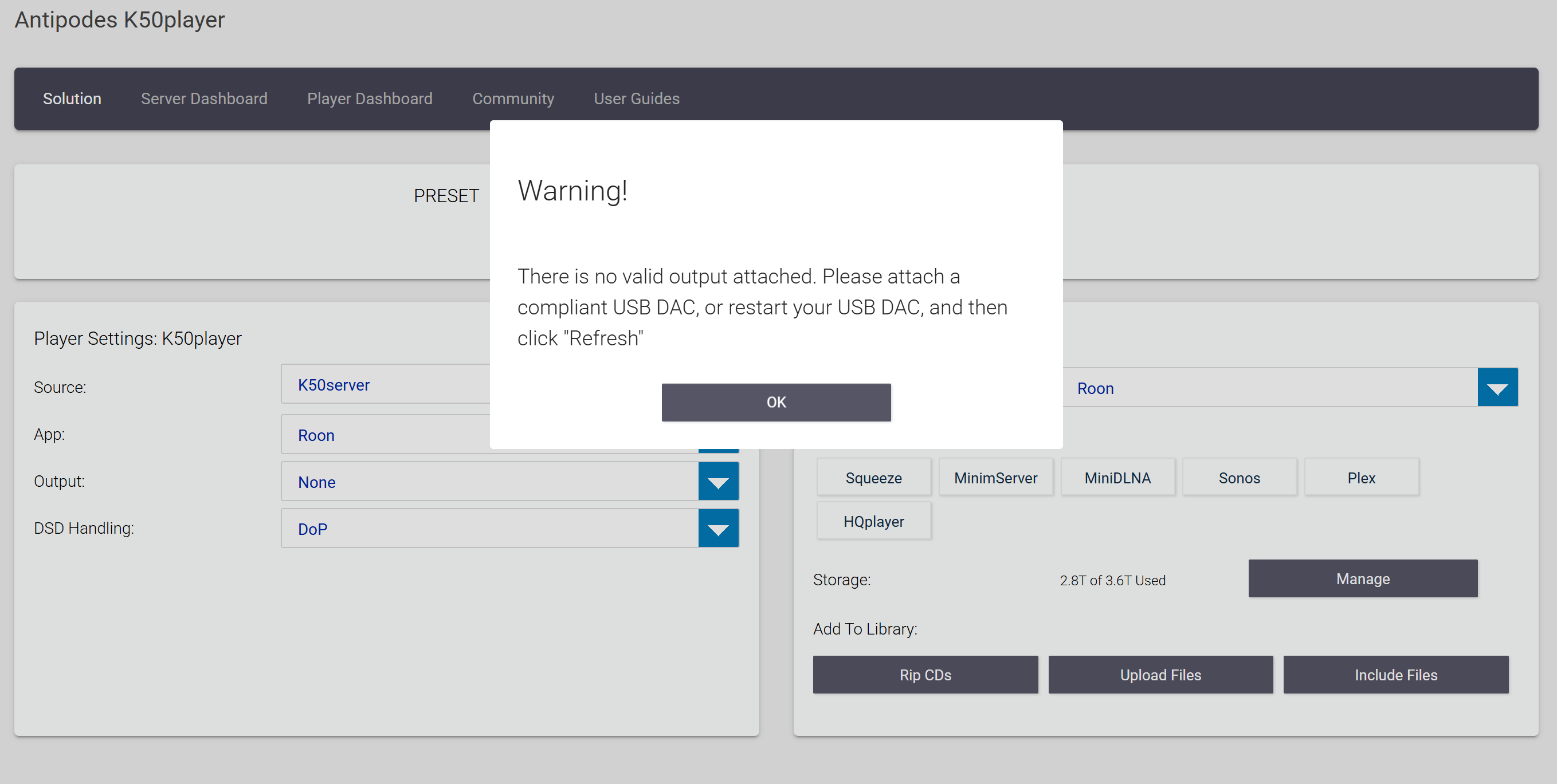

Help!! I was listening to music, and suddenly no more sound…this is what I found as a message on the K50 web page:
I should point out that I do not have a USB Dac, the K50 is connected via Digital AES/EBU to my Trinnov CI
Output should be set to Digital Audio. You may need to restart to get your DAC to be re-recognized.
Yes I know but I don’t even have the “digital audio” option anymore…I already restarted everything
The order of restarting could have impact. Perhaps try to restart both but first K50 then dac. If this does not work try the reverse order. This happened to me once long ago but managed to get it working again.
Phew…after 3 reboots, it works again, but I had to restore a Roon backup…I no longer had my albums or my playlists…thank you!

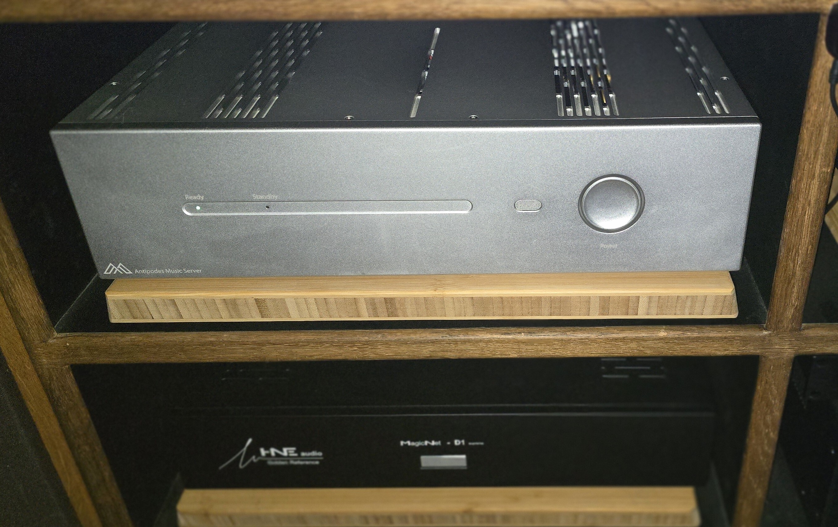

:smiley:Today… the return of the prodigal son.
Well… I don’t think this one is going anywhere anytime soon… maybe when I’m very old and can no longer tell the difference between my FiiO SR11 and the K50… but hey, there’s still time (though that day will come, alas).
And just a quick note: Antipodes’ customer service is simply exceptional!
A huge thank you to Mark Cole at Antipodes, and to Torsten Fink and Markus Floter at CM-Audio (German support)… hats off to them! :smiling_face_with_three_hearts: :blush:
