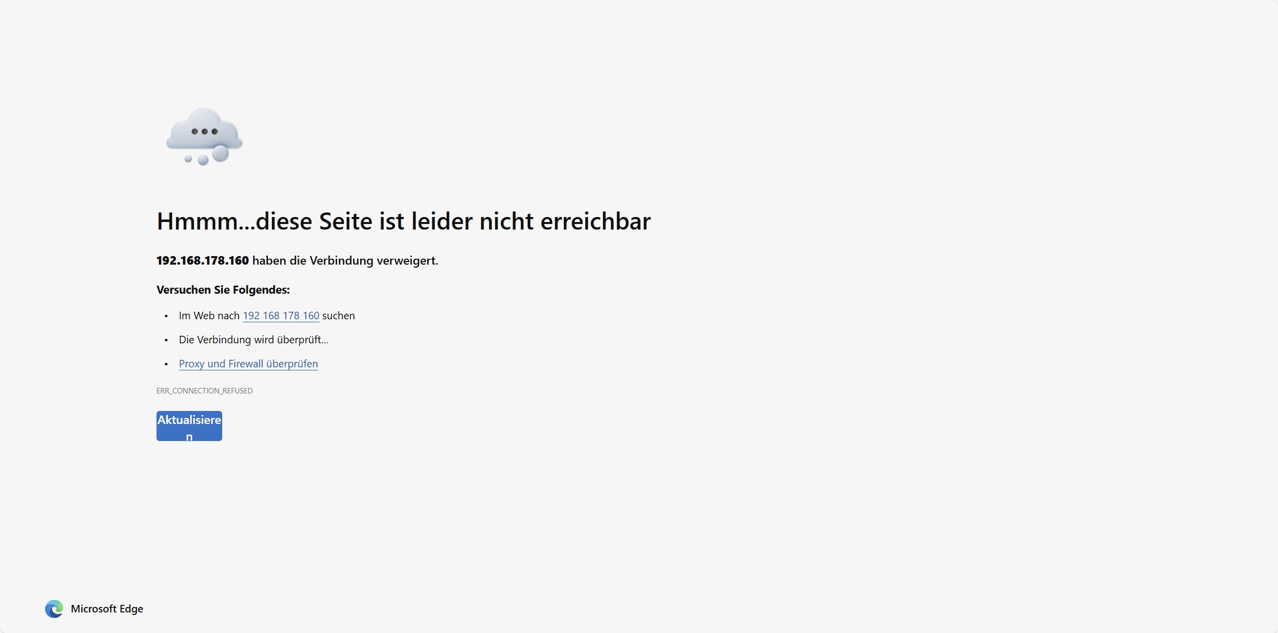

I need help setting up the HQPlayer. I want to run it as a player together with Roon as a server on an single Antipodes EX (Oladra upgrade). After selecting the preset “HQPlayer with Roon Server (Auto)” in the Solution Dashboard and adding the HQPlayer on the iPad, I click on “Open” in the Solution Dashboard to configure the HQPlayer. However, the “/config” page cannot be opened and I get the error message “Safari cannot open the page “192…:8088/config” because Safari cannot connect to the server “192…” every time.”
What am I doing wrong? Many thanks for your help!

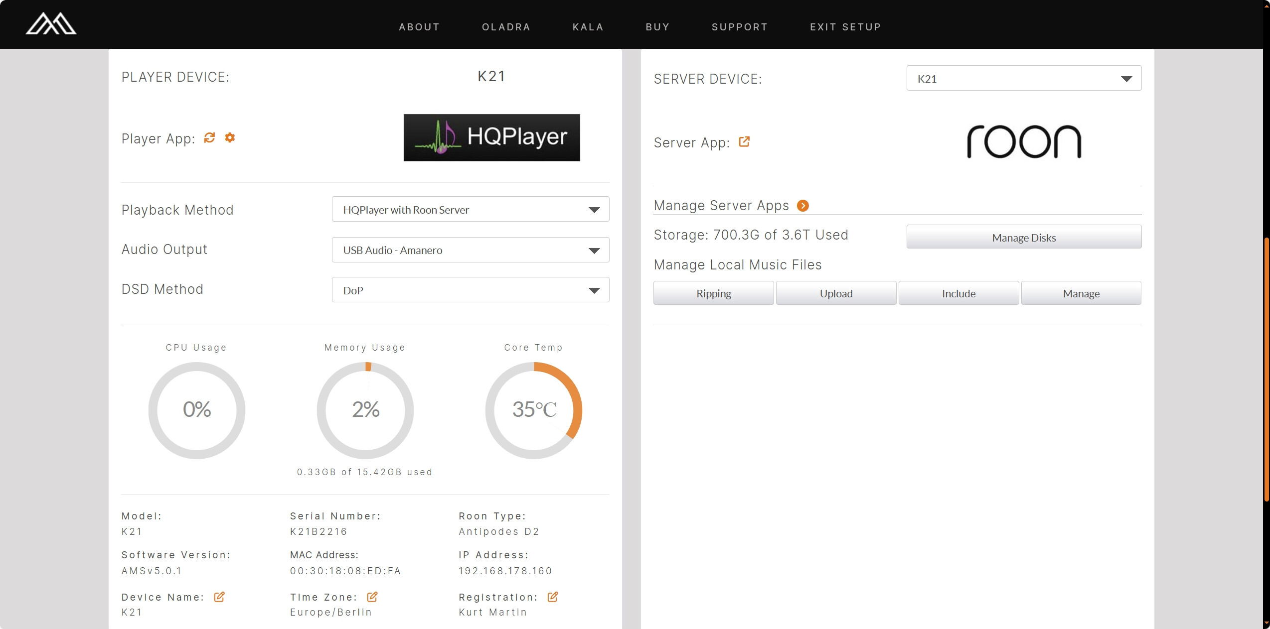

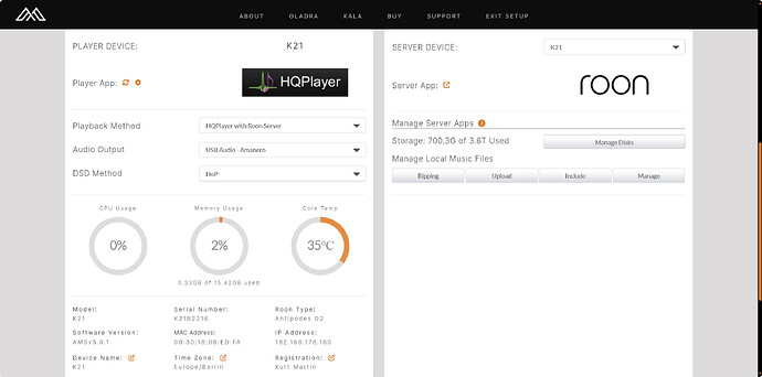

I have sent you two screenshots to illustrate the problem.
Picture 1 is the configuration of the K21: HQ Player with Roon.
Picture 2: the error message when I try to configure the HQ Player.
Greetings Kurt
Hi Kurt, no that is not possible as to run HQPlayer in that configuration HQPlayer Embedded is required.
As mentioned HQPlayer Embedded is required to run in tandem with Roon on the server side to get ROON+HQPLAYER, the K21 cannot run HQPlayer Embedded as Signalyst removed support for non-AVX devices, which the K21 is.
The reason that pre-set is available in the menu is that the PLAYER is used to config both server and player, so when a K41 is attached the K21 sets all parameters for both devices.
I say again, HQPlayer is not able to be run on a K21 unless used as a NAA device to and Embedded server.

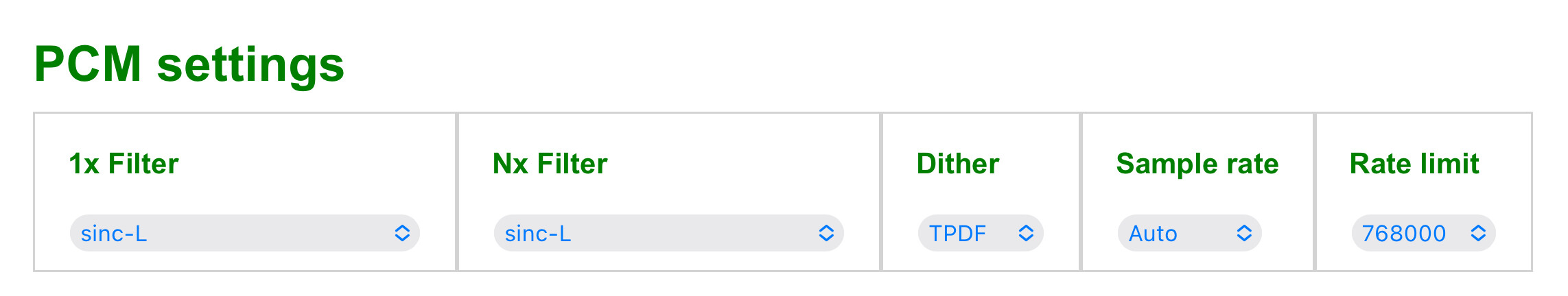

Definitely not as far as DSD scaling. They match up well though if one opts for PCM scaling.
Thanks for your contributions. My idea is to upscale music with 44 kz 16 bit in the HQ player. So pure PCM scaling. Who has experience with this?
Greetings Kurt
Thanks for your contribution . It helps me a lot.
I do. Just set Output Mode to PCM and then choose the filter that sounds best to you. Make sure dither aligns to the max rate (this can be difficult to figure out as the documentation is poor). The dither I use is what Jussi recommended in passing when rate is 16FS.
