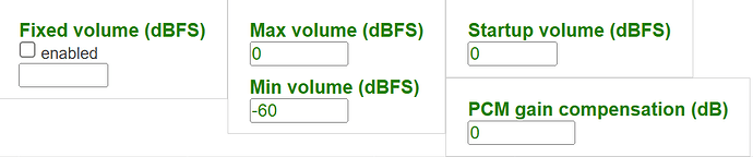

Hi guys, the HQP on my S40 has the max volume stuck at -3. Any other max volume setting works when setting volume lower than -3, but anything over -3 doesn’t. Meaning I cannot set it to 0 for example.
Also, the volume is always fixed, as I cannot change the volume even if the Fixed volume setting is disabled.
What do you have min volume set to?
Min is at -60, adaptive volume is off.
Weird. Did you try restarting HQPlayer?
Yeah very strange. Restart doesn’t help.

Prince got it fixed by reinstalling the HQplayer to a newer version. The volume was somehow stuck even though the xml config looked fine, probably an old HQP bug.
