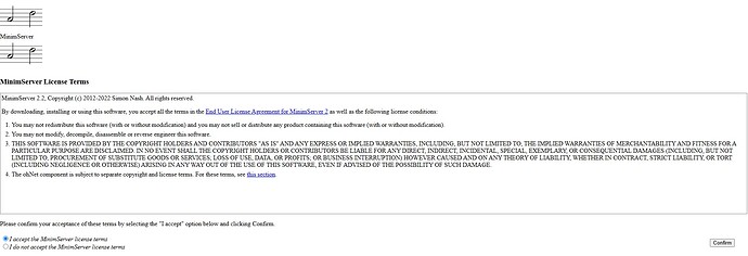

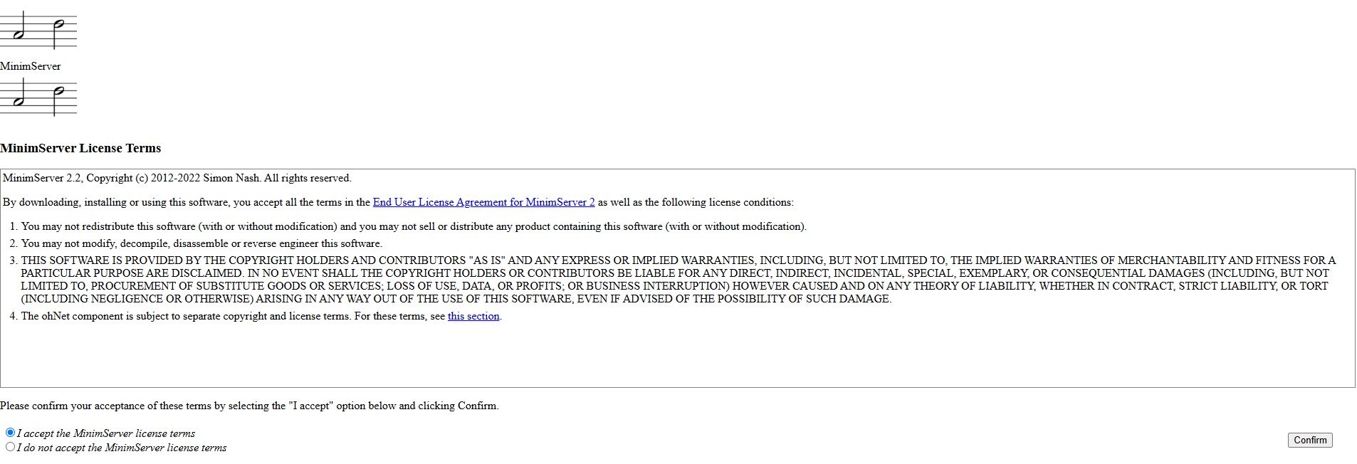

When using MinimServer for the first time you need to click thru to accept the Minim terms and conditions…

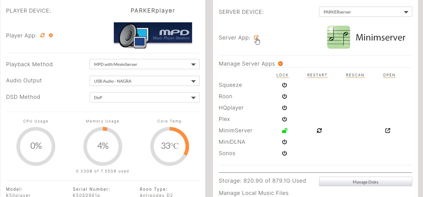

Click Server App

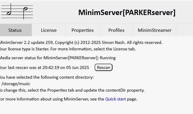

Launches Minim and you see the below…
Click Accept and Confirm. You should see the status of Minim on your device as below…
