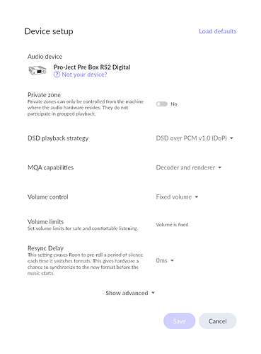

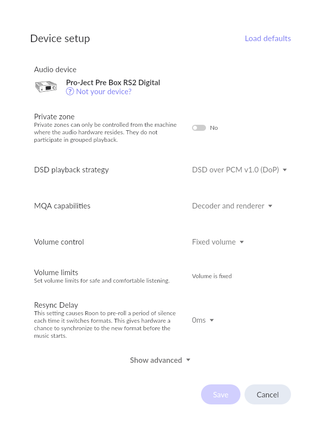

It looks like your DAC will be limited to DoP when using a Linux server as ASIO is required for native DSD. Make sure DSD Method on the Solution Dashboard is set to DoP. Also see if you can configure DSD playback strategy from within Roon as DSD over PCM. The following is an example that I just randomly grapped.

For DSD64 and DSD128 the Antipodes DSD handling should be set to DoP for the Linnenberg Satie.
