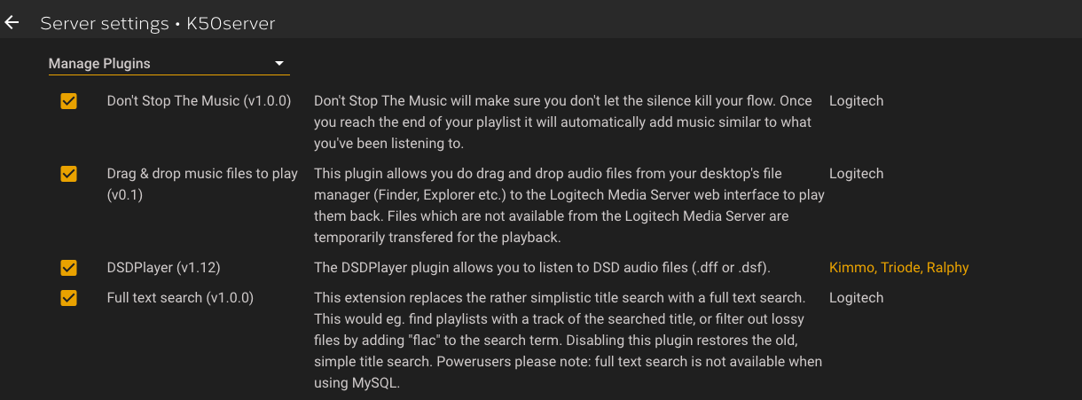

Sounds like expectation bias. :slightly_smiling_face: Once you overcome the less friendly user UI of Roon, I think you may in for a nice surprise. Make sure you activate the DSD plug-in. Let us know what you think.
