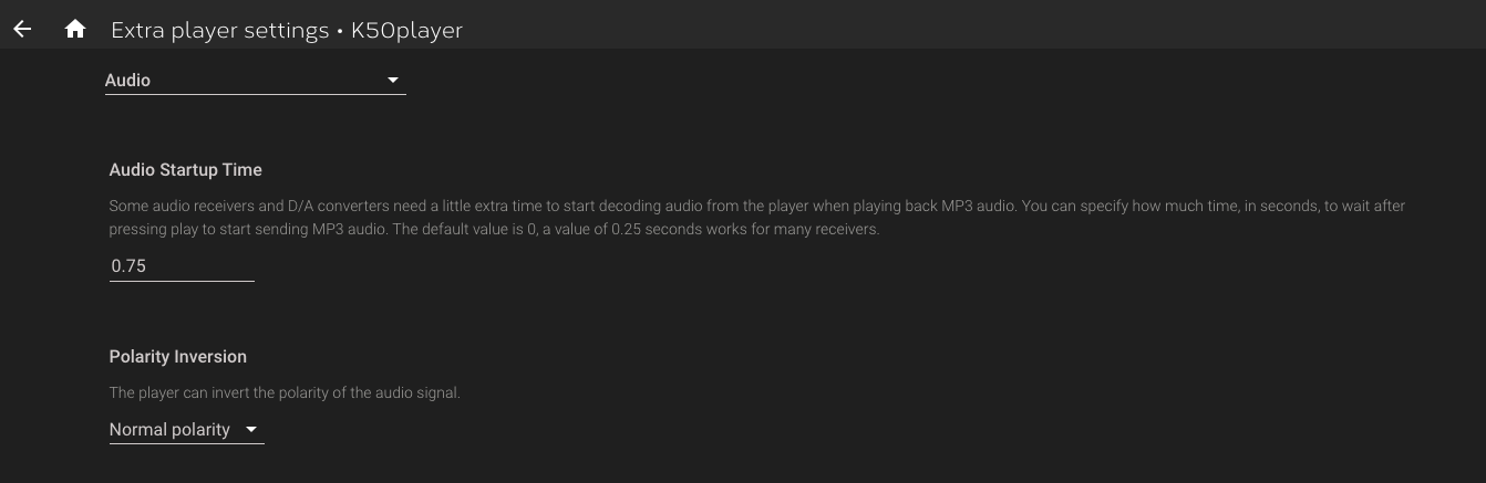

Go to Extra Settings under Playback Settings for Squeeze. Then choose Audio from the dropdown and scroll down and you will see Audio Startup Time. Try a higher value to see if it makes a difference.

Yeah it might be MP3 only but much of Squeeze was developed back when MP3s just became a big deal. I asked Copilot. The response:
The Audio Startup Time setting in Logitech Media Server is not limited to MP3. It can benefit any format that requires a brief buffer or decoder warm‑up, but the effect is most noticeable with compressed formats (MP3, AAC, Ogg, WMA).
Uncompressed formats (PCM/WAV/AIFF) and FLAC usually benefit less, but still can depending on your DAC and network path.
What Audio Startup Time actually does
Audio Startup Time inserts a small silent buffer before playback begins. This helps with:
• Decoder initialization
• Network jitter smoothing
• DAC lock‑on time (some DACs need 50–200 ms to lock to a new sample rate)
• Avoiding the first “click” or truncated audio frame

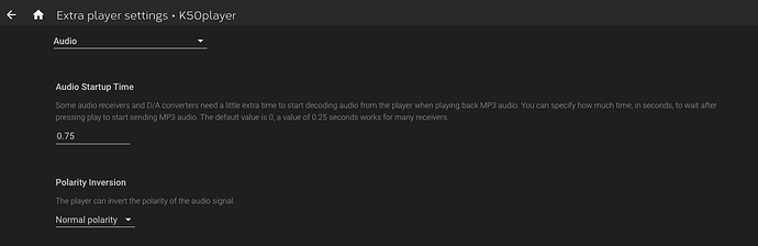

Interesting that when Squeeze mentions “MP3” it means all stream formats. I also get a fraction of second of the beginning of songs truncated with my latest DAC. Unfortunately changing the setting from 0, to 0.25, to 0.5 to 0.75 made zero difference.
Now that I see the screen shot, I recall making that adjustment - think I went to “1” and no effect as well.

I concur with Watts, entering various numbers in the setting has absolutely no effect.
