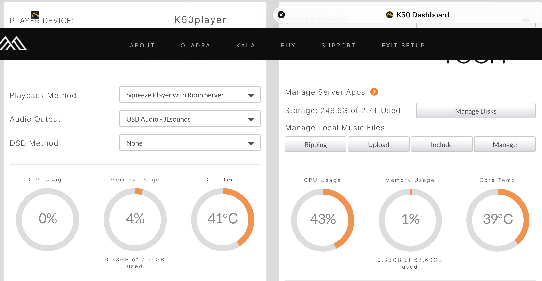

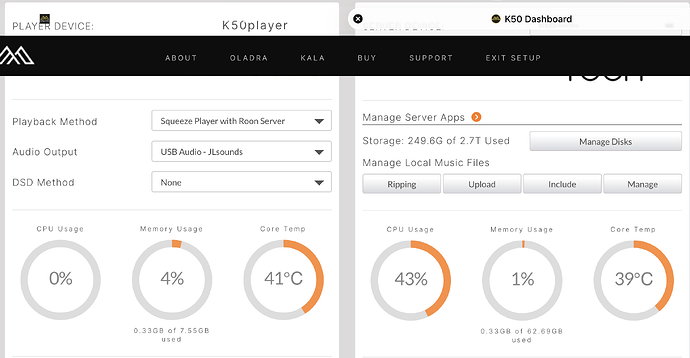

No apparent issues for me with Roon/Squeeze, it plays fine, but the CPU bounces from 1% to 40% upon last view.
By comparison Squeeze/Squeeze stays at 0% for both player and server, and it sounds so much better with a recent A/B of a few tracks, seems like an easy decision to me to stick with it.
Is your Squeeze/squeeze fine? It is acting up just when using Roon server?
For apples to apples comparison you have AMS 5.0.1, and Roon build 1559?
Yes, I have the latest software and Roon build. This issue just started a few weeks ago. I listened today with no issues and the Dashboard showed 0% CPU for the Server and Player. I’ll see how it is going later in the week again.

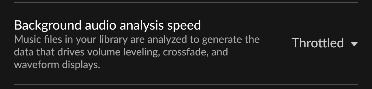

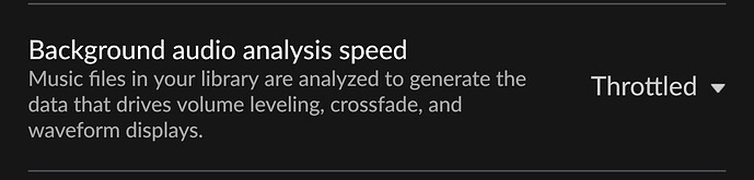

What do you have the following set to? It’s under Settings…Library
Yes, that is the setting I have. Settings haven’t changed in a year and a half. Got the software update on the K50 last winter. No changes until 3 weeks ago when I started experiencing these current issues.
