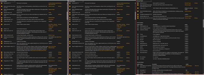

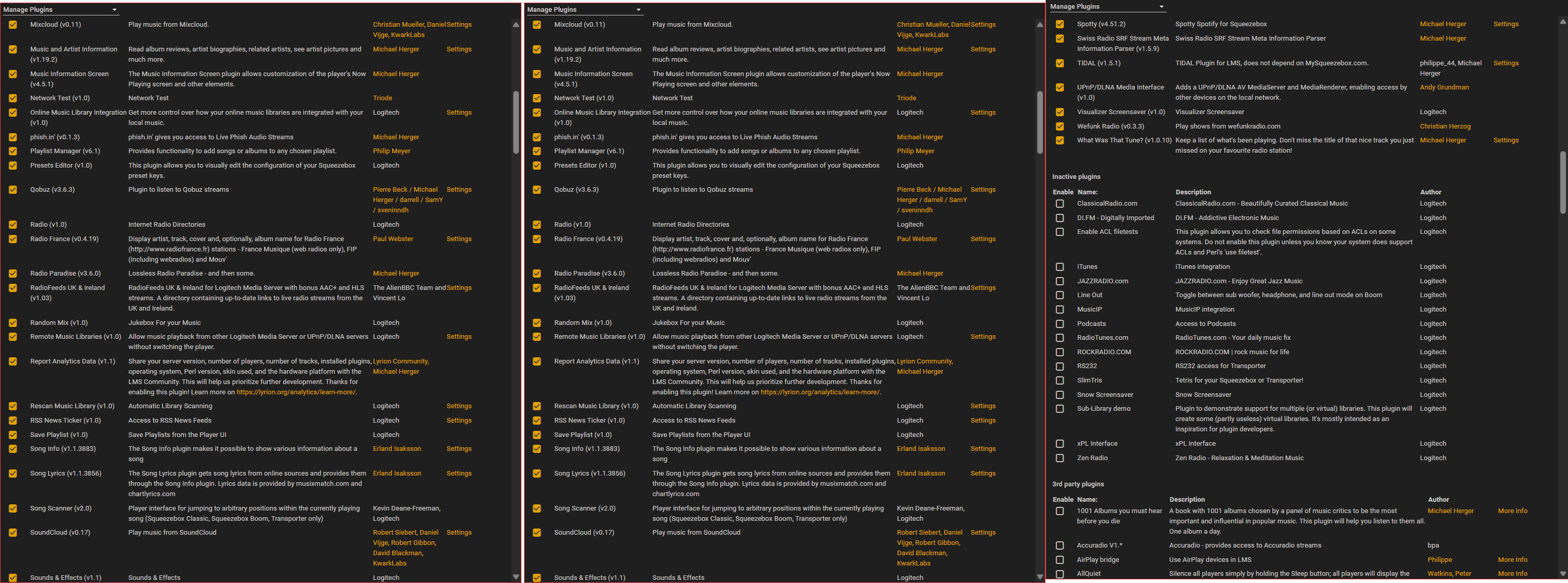

I have these plugins enabled. Should I disable all of them and just keep the Tidal one? Thanks.
The default set of enabled plugins hasn’t been causing the problem you reported. What I wondered was whether you went in and enabled something else as that something else might be the culprit. If you didn’t manually enable one of these then it’s not a plugin that’s causing the issue.
One exception though is the C-3PO Transcoding Helper plugin. I can’t tell if this is checked for you, but if it is you might want to try unchecking it.
