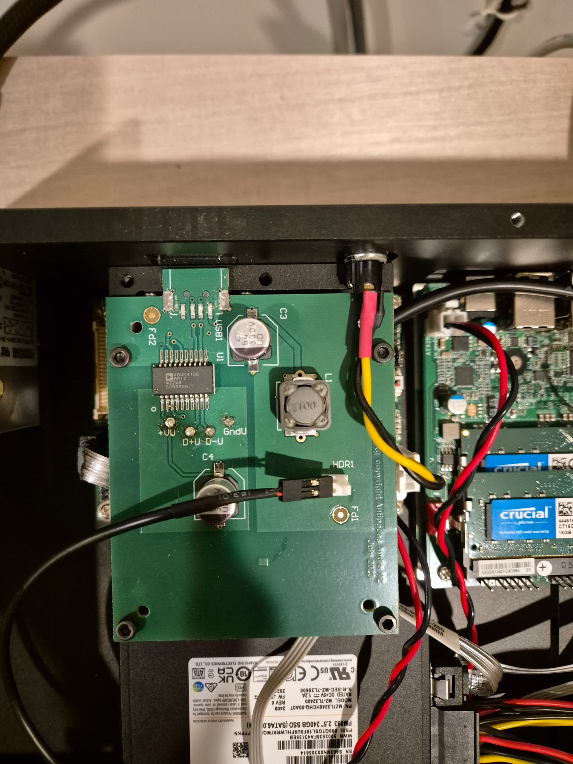

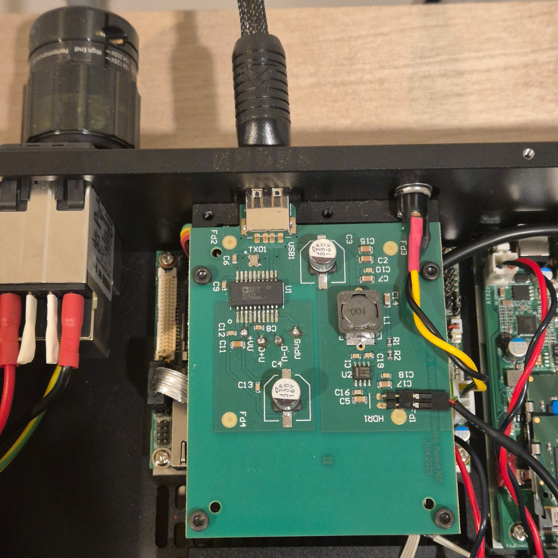

@kennyb123 @Luigi Yes it was me that had issues with the USB cable being loose in the socket to my K50. I have searched but cannot find my posts about that. My problem was with the original K50. When I upgraded to the mk2 K50 my recollection is that a better usb socket was used but more importantly the clamp mechanism mounting of the usb socket could be adjusted and I was able to cure the loose usb cable problem. That revised usb socket and adjustable mounting was carried forward to the Oladra that I now have.
So Luigi if your K50 is not the original one I suggest maybe try adjusting the usb socket to be a tighter fit. It does involve going inside the K50 but it is not difficult.

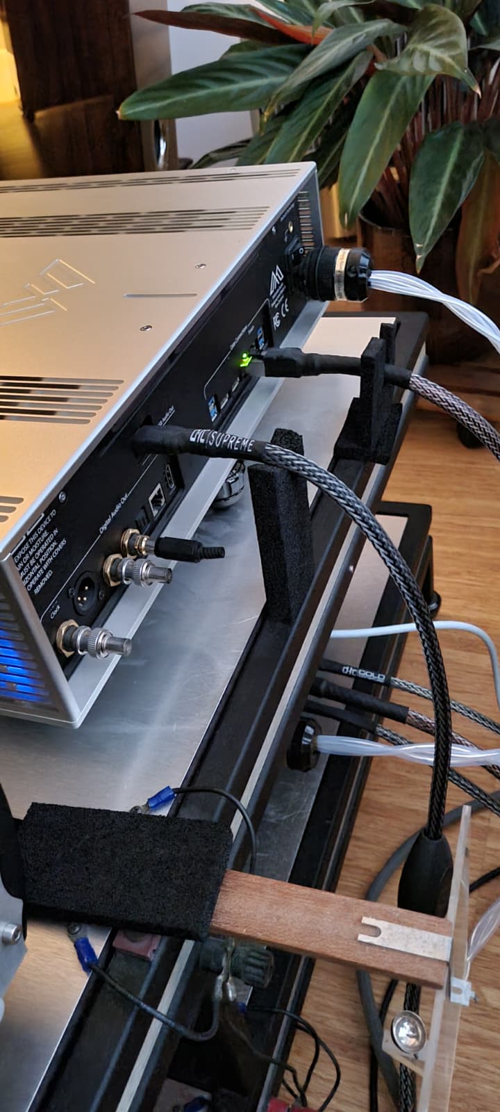

I elected to leave as is, while also trying my best to route the USB cable in a way that makes it less prone to coming loose.
I designed a support that utilizes the recess in front of the socket and had it made by a 3D printing lab. Now the cable makes perfect contact and doesn’t slip out. However, I don’t think it would have taken much effort for the Antipodes designers to implement a less fragile socket.
