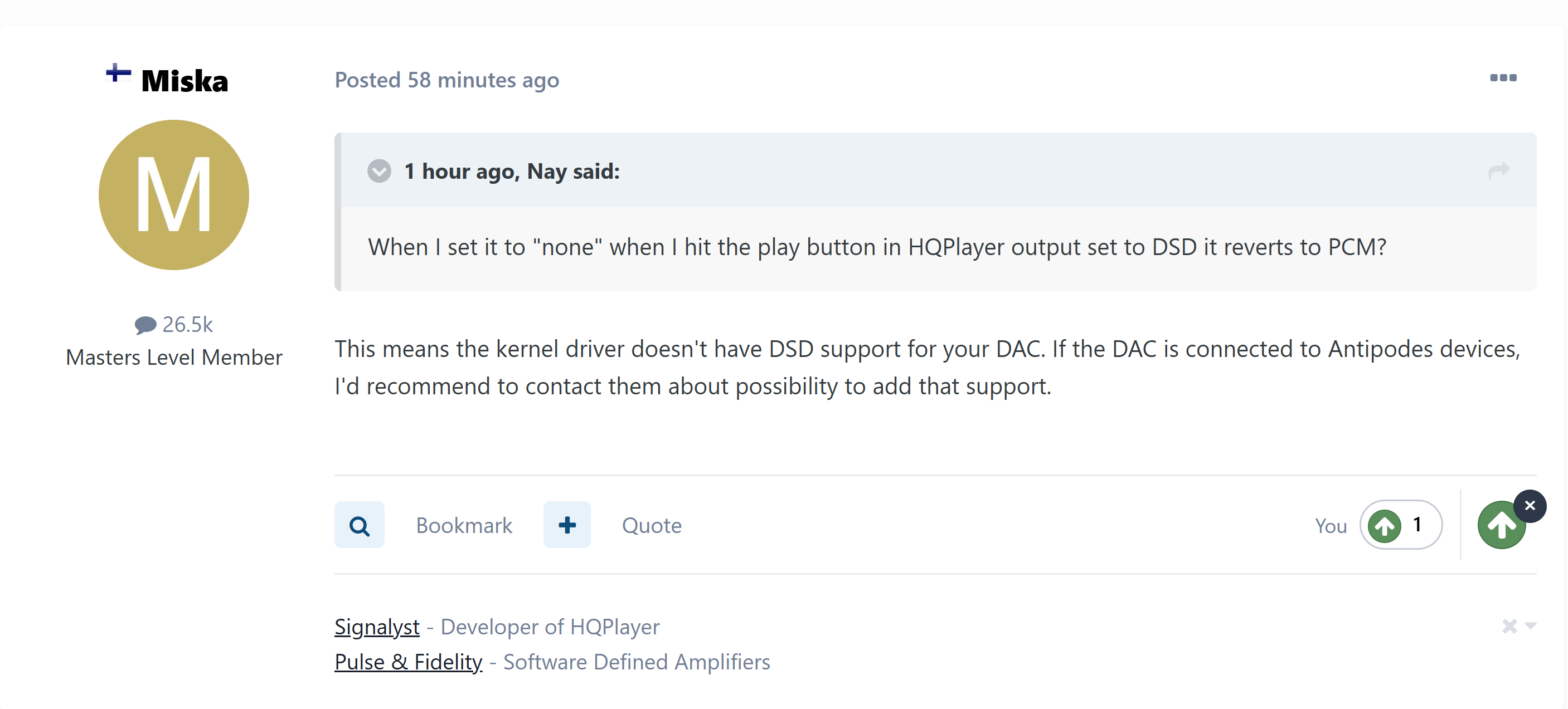

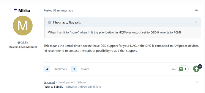

The “none” part I wrote is revering to a setting in HQPlayer and not the EX Dashboard.
It’s a bit of a challenge to follow how you are explaining your issue. Taking a guess here.
It appears from the screenshot you shared that Jussi was only responding to the choice of “none’. That setting has the same effect as the kernel driver appearing to not support DSD, because setting to none tells the driver to not support it,
That you’ve been able to play DSD256 - I think - proves that the issue isn’t with the kernel driver.

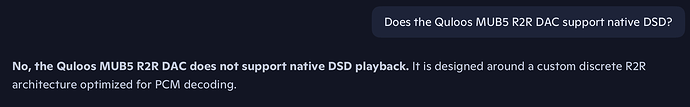

There could be a number of reasons why DSD512 won’t play. The lack of native DSD support could be one of them. Can you post a screenshot showing where the manual for your DAC shows that it supports native DSD? I could find nothing that confirms this so I asked Copilot:

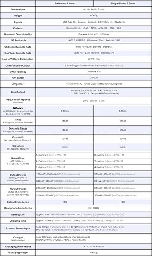

See attached for MUB5 Specs. Thank you
I note in the spec that there is no Linux support for USB
@MarkCole I had not noticed that. Can this be updated to allow this?
The DAC manufacturer must supply USB information so that it can be added to the Linux kernel.
This information is kernel-specific and not added by Antipodes Audio; rather, by the people who manage the releases of Linux kernel updates.
Reach out to the DAC manufacturer regarding Linux support.
DSD256 is supported by DoP but DSD512 is not. It sounds like native issues supported by your DAC.
