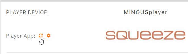

Is the OLADRA recognising the DAC is the Dashboard? Have you refreshed the Player ? Have you tried a different USB cable.

Refresh Button

I’ll try refreshing the app had not noticed the refresh button.
