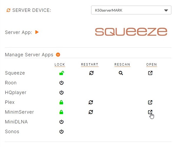

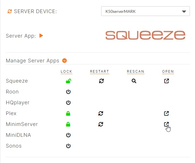

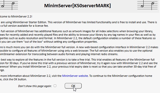

With Minim did you launch Minim from the AMS Dashboard to accept terms and conditions?

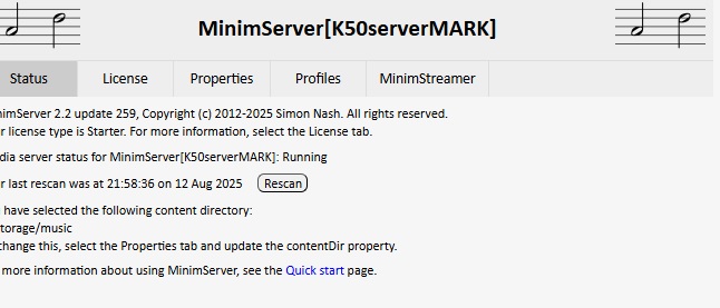

Hi Mark, there was an error, but an unrelated reboot seemed to have fixed that and then it was a case of pointing MinimServer at the music directory and now it seems happy, thank you
