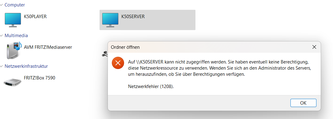

Hello, I recently purchased a Windows 11-based laptop. I’m having almost the same problem, except that the server and player are found and listed. I can also type admin/admin until an error message pops up. See screenshot. I enabled SMB 1.0, but that didn’t work. Switching between public and private networks didn’t help either. Any ideas?
This is a Windows thing, generally when it is asking for a password it is asking for the user name and password you use to log into the computer.
Is admin/admin what you use to log into the computer?
Other users have done this…
  1. Disable the guest fallback protection:
a. On the Start Menu search, type gpedit and start the Edit Group Policy app (i.e. Local Group Policy Editor). If you are using Home edition, skip to step e.
b. In the console tree, select Computer Configuration > Administrative Templates> Network > Lanman Workstation.
c. Double-click Enable insecure guest logons
d. Select Enabled > OK.
