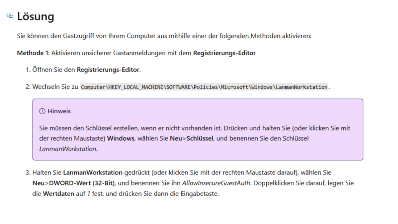

Hello,
I had the same problem with my K41. After a long search, I found a solution in Windows that works for me. It can be found at the bottom of the following page:
It’s in German. The image shows the most important steps. Good luck.
It worked the same for me on Windows 11. The registry entry was missing, and after I wrote it, it worked!
