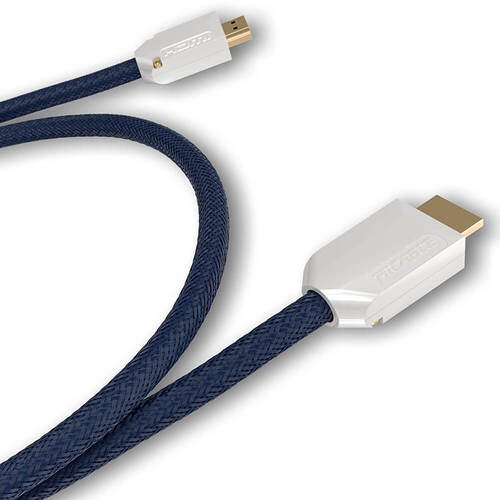

my previous cable was AQ firebird; my current cable is RiCable SUPREME MK2
I know the price difference is huge and some might consider it a “downgrade” but I A-B both and prefer Ricable in my system. The price of RiCable makes it so easy to just keep it if I found it not to my liking but in the end I sold the AQ.
In my system it adds more fluidity and emotion to the music, which is a very great combination with Antipodes server and MSB DAC.
