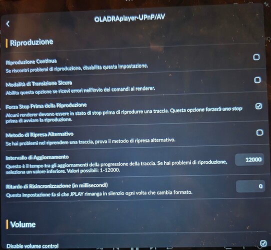

Maybe try to change a parameter in configuration, your player upnp , like my setting.
How big was the improvement by adding the Tempus?
In theory, changing that value will reduce network traffic to update the application. I’m trying 20 now and we’ll see. No difference at the moment.

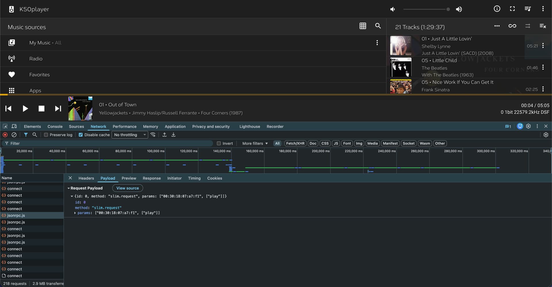

I realize that the screenshot that follows is a lot to take in, but what is shown is Chrome with the Developer Tools displayed along the bottom. This allows one to view exactly what calls the browser is making.
I’ve highlighted the call that was made when I pushed the play button. You can see that it sent the payload that included the word “play”.
This page sets a timer that has the browser running javascript commands that continually poll the server. It does this to get the playback progress.

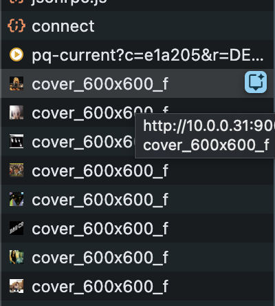

When the next song is the queue is reached, Squeeze has to update the queue. You can see in the following that it spit out and handful of album covers.
Thus what we see is that the browser is sends distinct commands to Squeeze either on a timer or after one interacts with the UI.
It seems to me that the only thing that might potentially be impacting sound quality is if the Squeeze settings aren’t exactly the same from browser to browser. I think it best to clear the browser cache before evaluating the differences so each instance of Squeeze will have the default settings.
