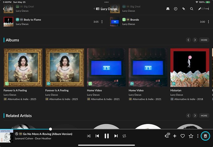

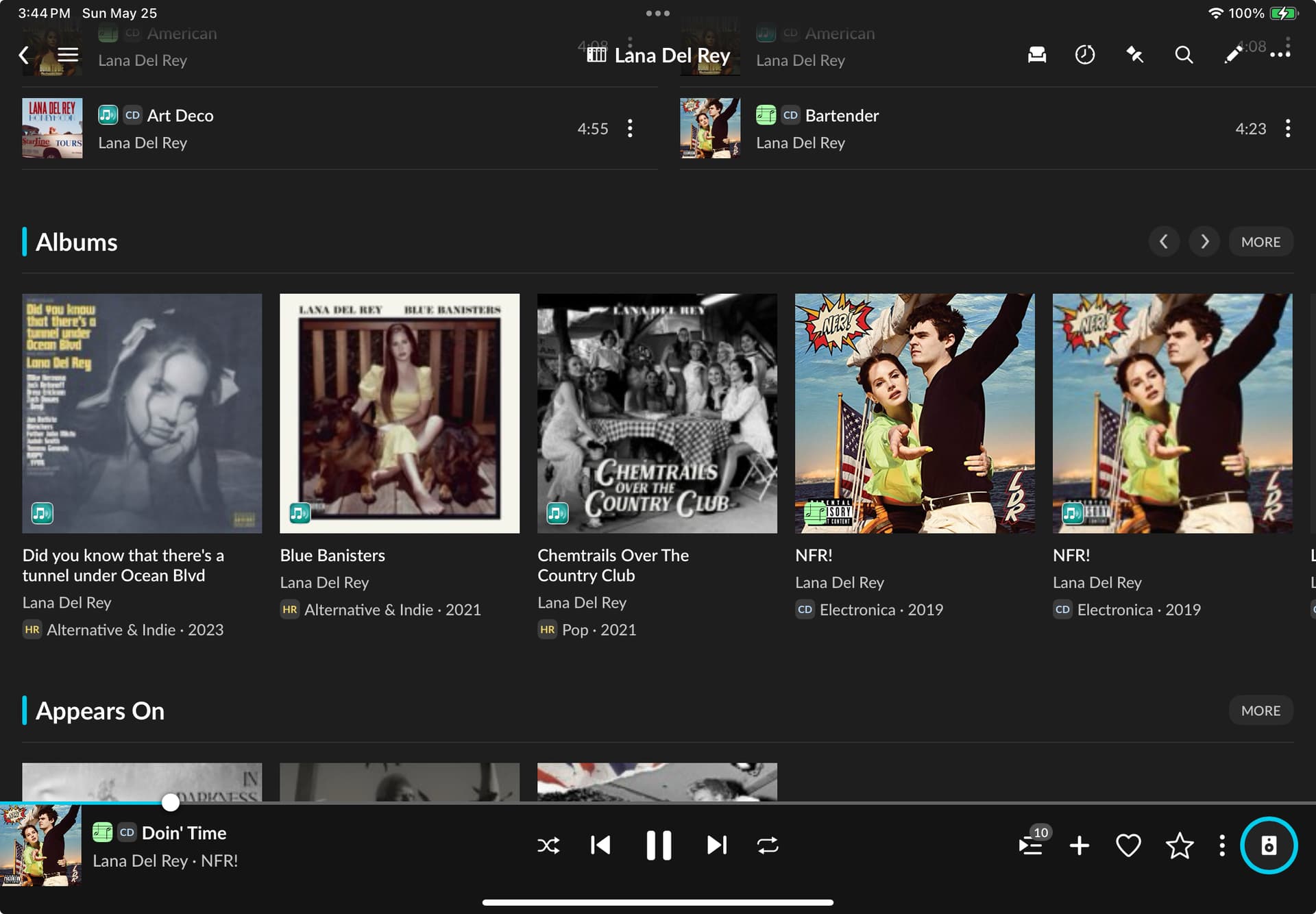

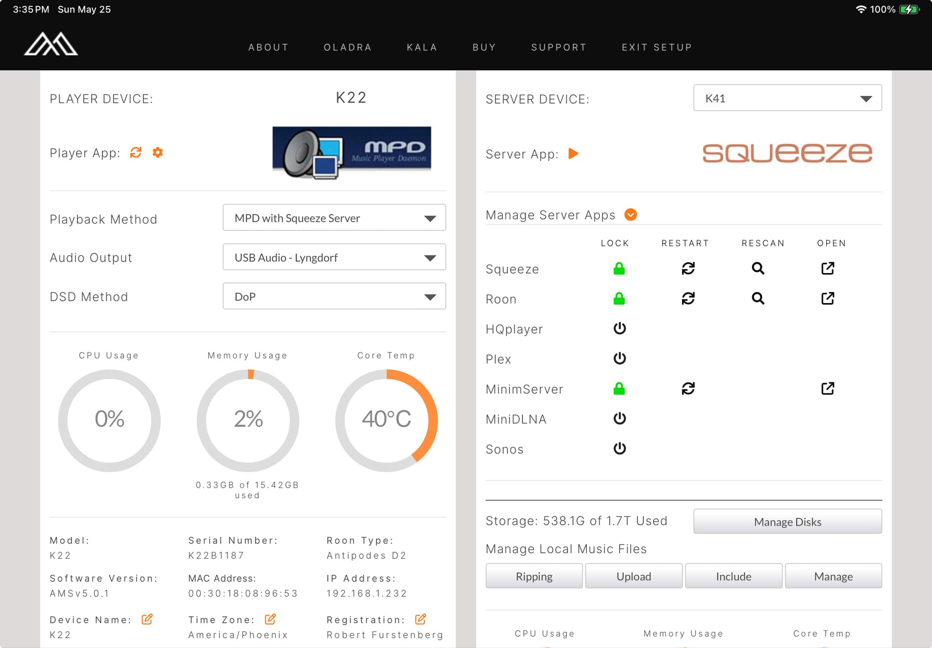

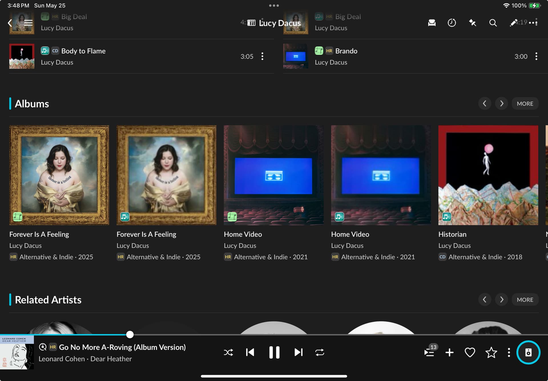

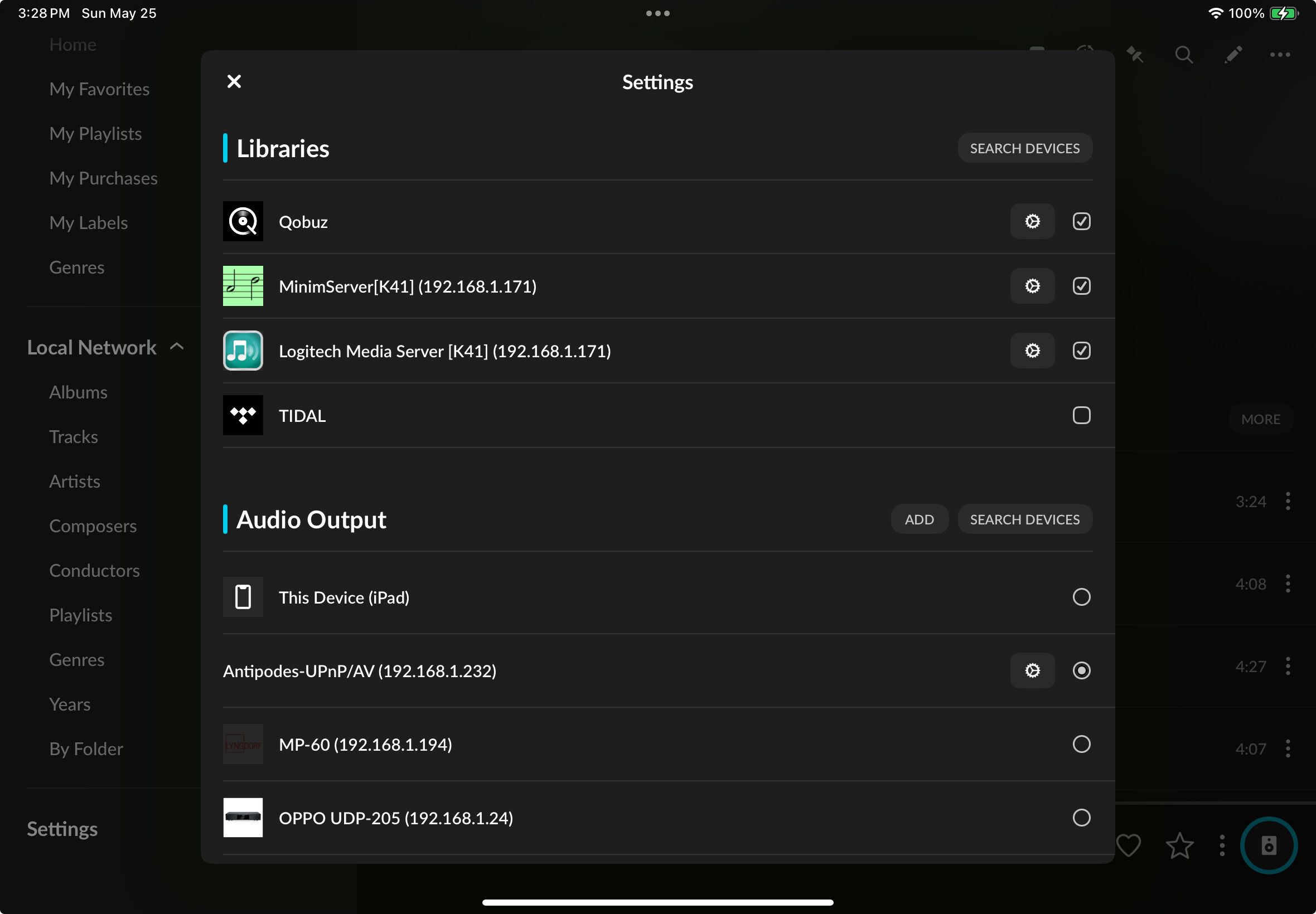

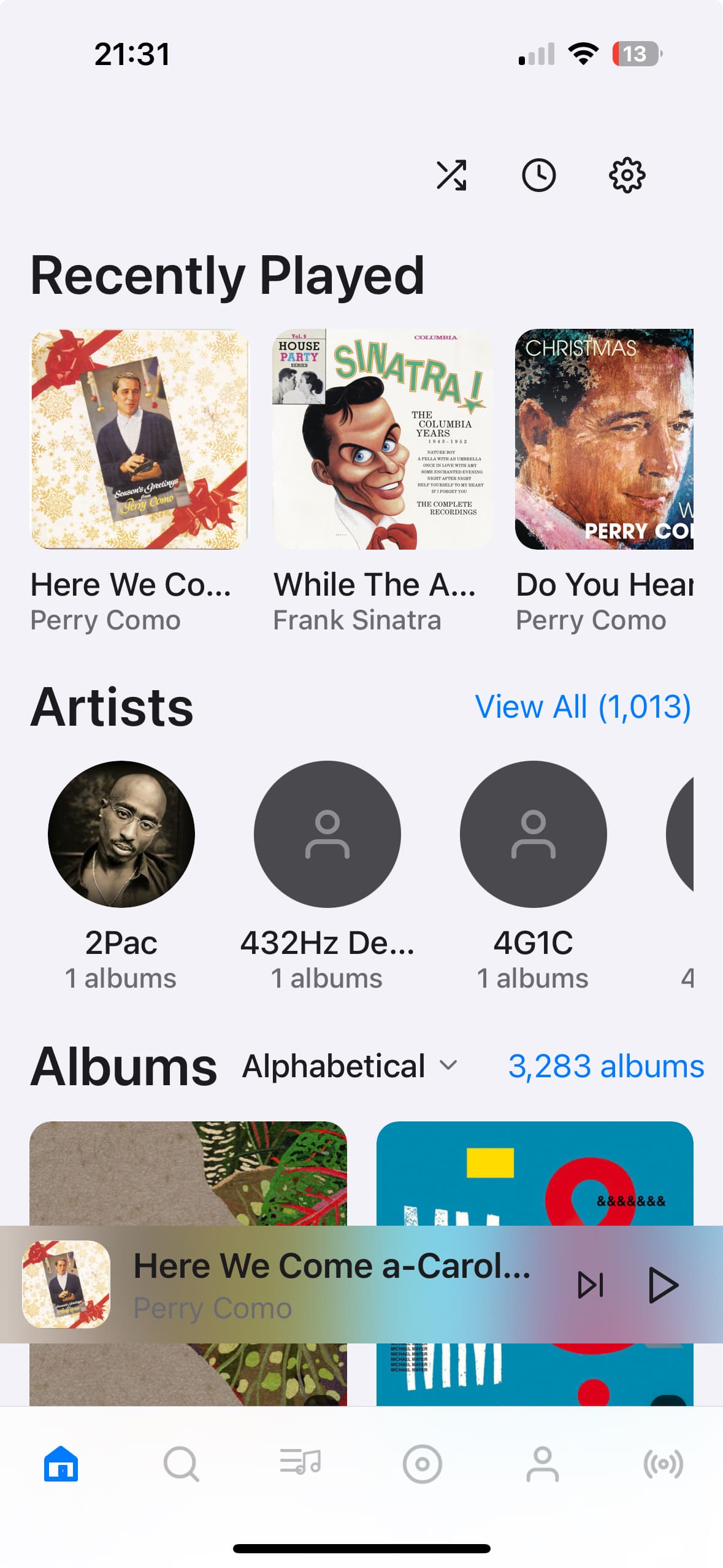

Thank you, @MarkCole ; appreciate the input but just to clarify ( and appreciate you bearing with me bc it IS a bit challenging for me) - but when viewing these screenshots does it appear I have everything configured properly to you? What REALLY confuses me that as configured I see most artists are expressing duplicate albums. One album plays and the other does not. In other words if we look at the latest Lucy Dacus album you will see two albums “Forever is a Feeling.” One album has the icon that resembles and appears to be tied to a “Jplay file” and the other appears to express an icon that = Squeeze. This does
not output any sound. for me. So based on this configuration, what am I listening to??? Thanks!
You should be able to play Qobuz via Squeeze, book a remote support session if you can’t get that to work.
You have two UPnP libraries enabled one is MinimServer and one is Squeeze Server.
Disable the one that you don’t want to listen to in JPLAY and rescan the library.

I let Mark handle the online troubleshooting. But it seems important to realize that you need to use either MConnect or JPLAY — not both at the same time. One control app at a time. If you alternate between them, songs will be queued by one app, so likely the other can’t play them. So, make sure Mconnect is closed and only JPLAY is open.
Everything seems fine to me, but if there’s a small bug, they’ll track it down. Good luck!
Ps your k22 output is over Ethernet, correct? No digital output? If you do play digital audio out I would think you have to choose MP-60 as output instead of UPnP?

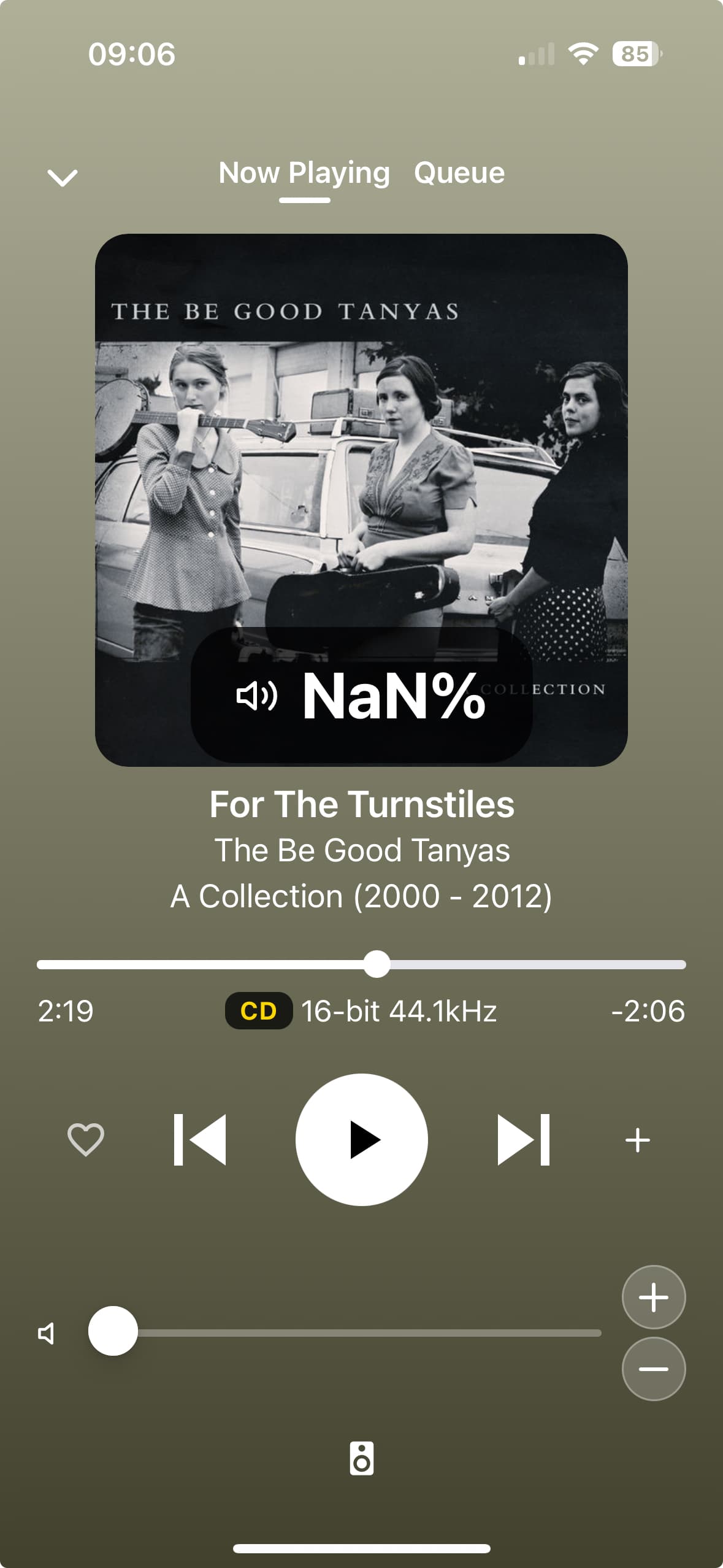

I am experiencing a slight issue with Jplay when using the slider bar. It sends the track to the position on the slider and plays from there as it should but the slider jumps back to zero and restarts but does not affect the position of the playing track.
Using Squeeze Player / Server.

Still experiencing this issue with Jplay when using the slider bar. It sends the track to the position on the slider and plays from there as it should but the slider jumps back to zero and restarts but does not affect the position of the playing track.
Also when playing an album it repeats a few seconds of the song just played before the next track.
Using Squeeze / Squeeze / jplay.
Anyone experienced this?

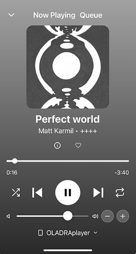

Click on the tiny icon at the top right that looks like a chair while playing the song. That opens a page with more information about the song. The slider on that page shows the time played and time left like in Roon. I haven’t seen problems with the slider stopping on that page; but I have not been using it long.
