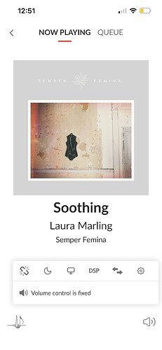

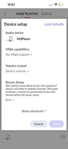

What is required to get HQ player to work on Roon with the K50
Yes i have that but still no volume control
Have you played a song and checked the Network Backend in HQPlayer Setup, I had to Apply in HQPlayer Setup, as it takes a bit for Roon and HQPlayer to connect.
when i choose the roon+hqplayer solution, network audio is automatically selected as backend in hq settings. if i click apply, without changing anything, and play a song, roon still has no volume control. also tried changing to alsa, then apply, then back to network audio and apply again and tried changing device volume to fixed and back to device again. still doesnt work

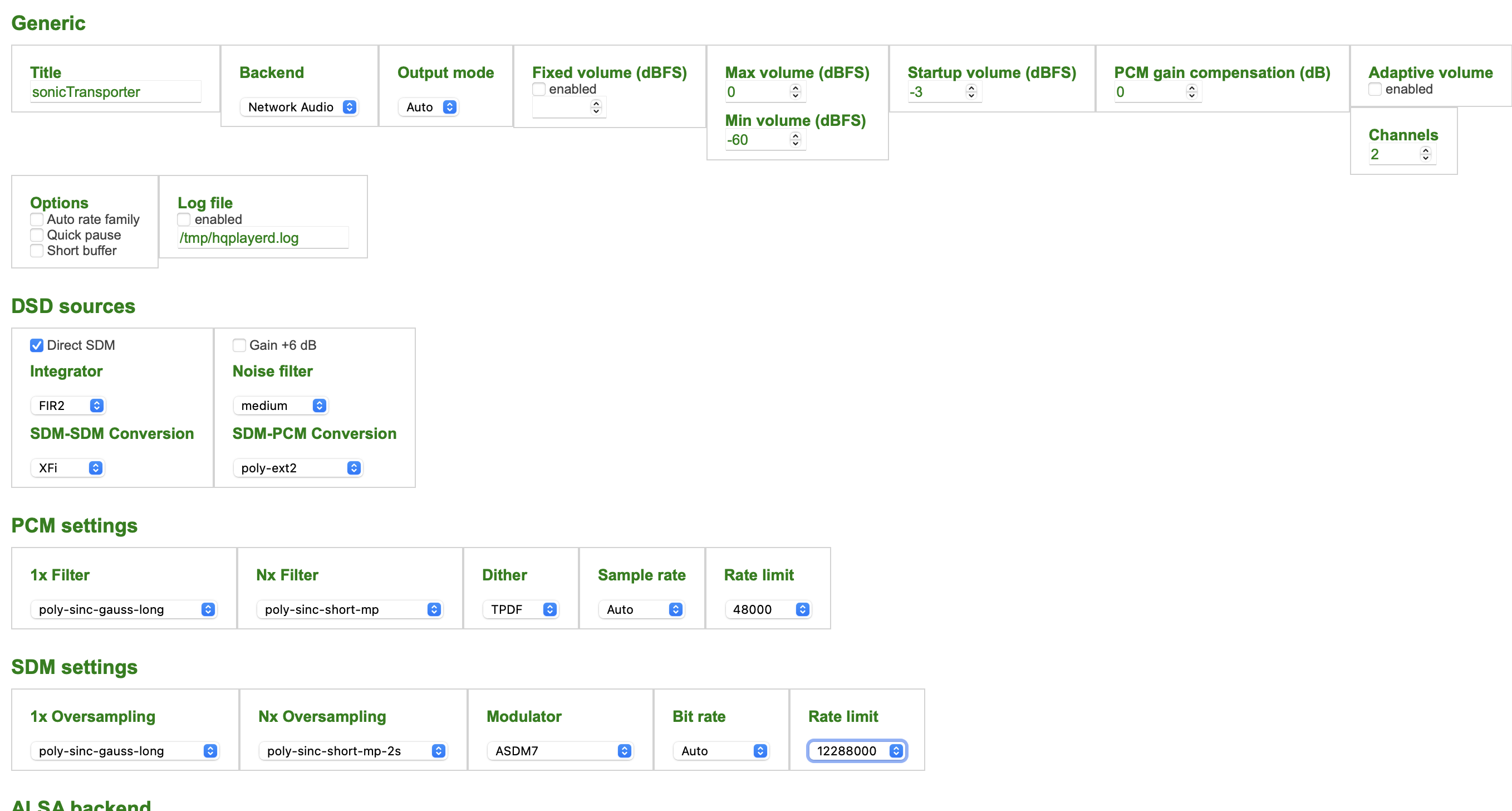

Its the same process as Squeeze, but disable direct SDM
which one of these settings disables direct SDM?
Easy one: uncheck Direct SDM
thx, i was looking in the wrong place.

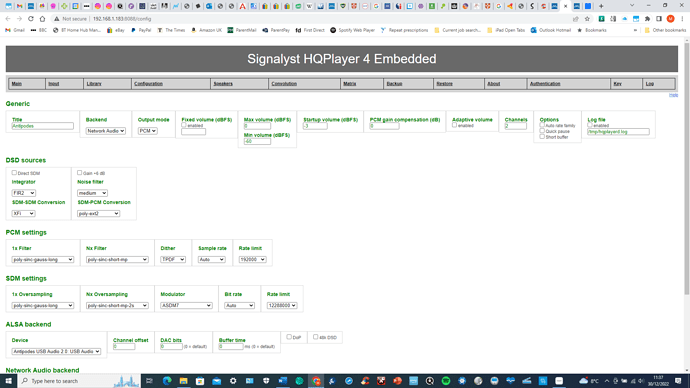

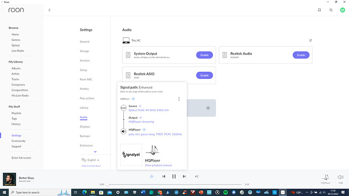

I have chosen HQP in Roon as the audio zone. K22 doesn’t appear anywhere in Roon as an option. When I press Play on a track what I see in Roon is shown below.
What I see in HQP is also below. You said ā€˜Use Network Audio, select the correct output in Network Audio drop down box at the bottom of the page, ie USB 2.0 is re-clocker’. So to clarify:
  1. In section Generic I select the backend as Network Audio, correct?

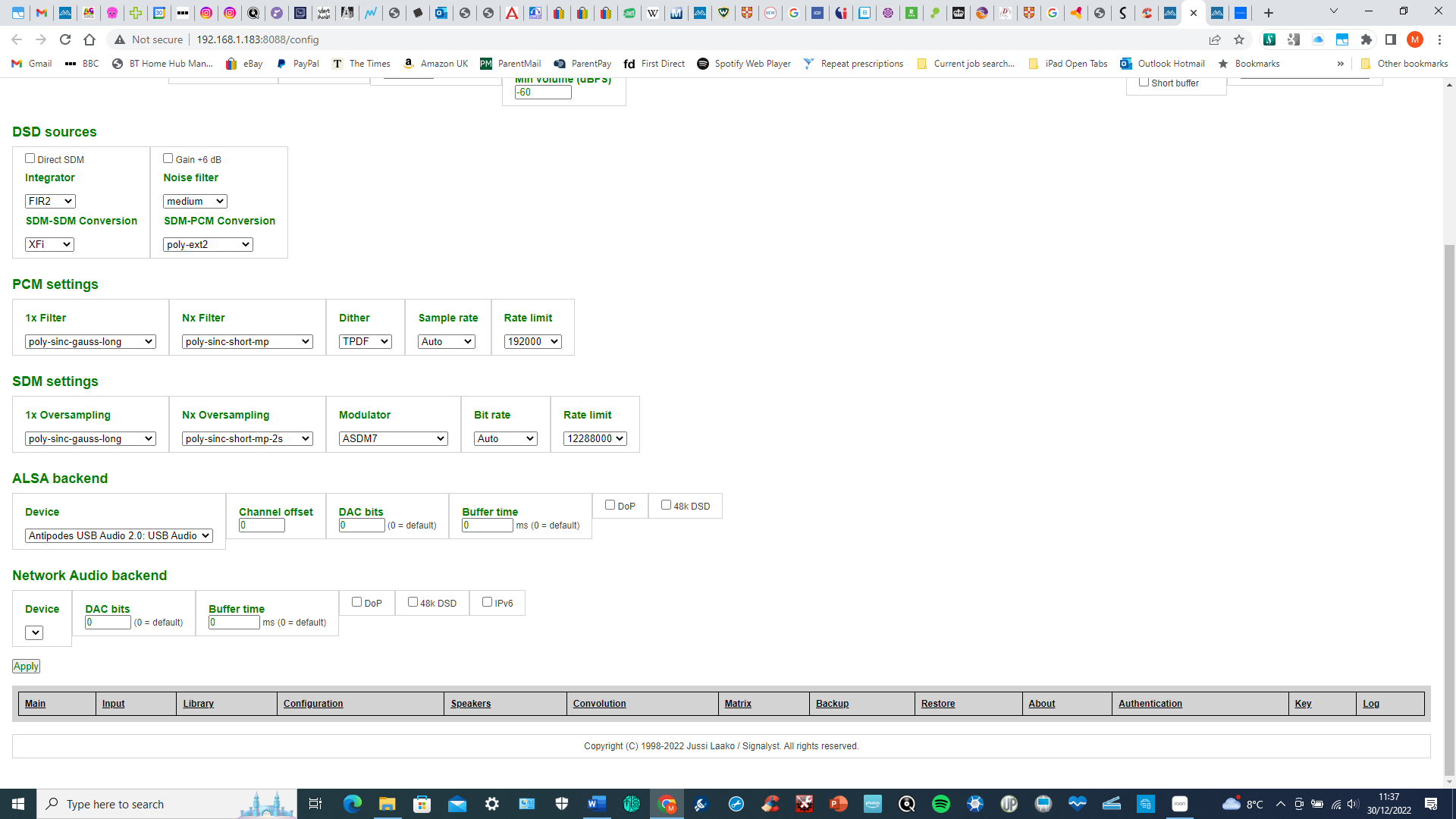

  2. In the ALSA backend section under device all I can see is Antipodes USB Audio 2.0, despite the fact that the K22 is connected to my DAC via SPDIF cable: is that correct?
  3. Lastly, in the Network Audio backend section there are NO devices available in the drop down menu, is that correct?
This is really frustrating, and given that HQP is quite widely used by people who stream music I don’t see why this is so difficult.
The K22 aims to be a Player, but it sounds like you are using it as Player and Server. Am I correct?
If so, this is why configuration isn’t straightforward. If you only have a K22 in the mix, the network audio section should be blank. And you would need to use the dropdown in the ALSA settings to switch to the other device to get spdif to work. Both devices will be labeled USB, but one will actually be the reclocker.

In the ALSA dropdown I only have one option, which is Antipodes USB Audio 2.0. There’s nothing else there.

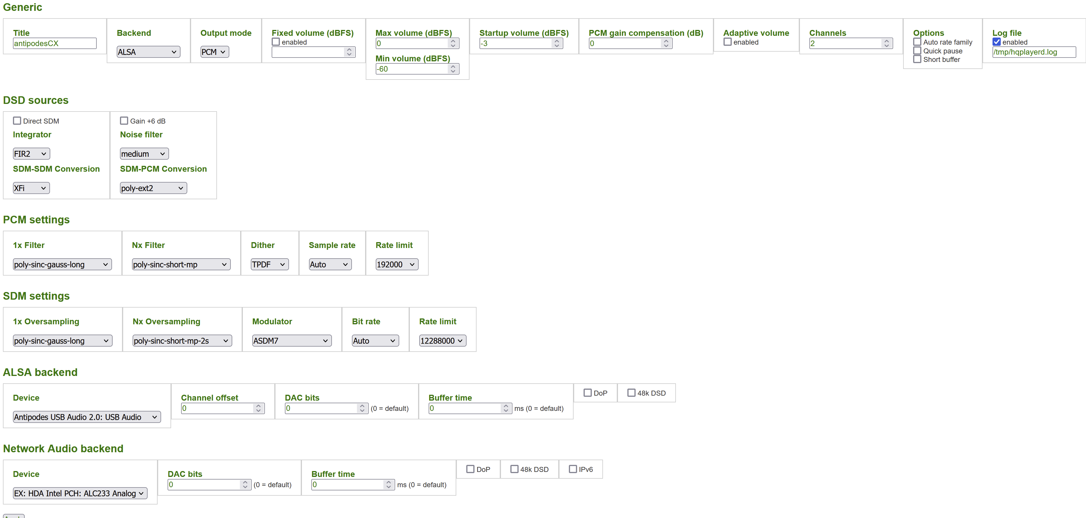

I don’t have a K22, nor do I have a Roon sub. I do have a CX and a P2. I have this HQP configuration (pretty much the default one):
I can confim that, using the HQPlayer app (Library) I am able to play tracks with my DAC connected to the Coax output of the P2. I would imagine that the internal K22 architecture is similat to CX via USB to P2. So the issue may be with the Roon->HQP setup … not much help I realise.
Good move to have backend set to ALSA. Looking at the config screenshot @MPSXB shared, I see that he has it set to Network Audio. That won’t fly in his config.
@MPSXB please share the current HQPlayer configuration please? And let us know your DAC and which output you are using.
Thanks very much to all. I now have the K22 plus HQP plus Roon working.
The K22 connected to an Audio GD R7 2020 HE DAC by spdif. The DAC is then connected to a preamp.
In the K22 Solution tab I have selected HQPlayer with Roon Auto.
In the HQP embedded screen I have selected Generic Backend as ALSA. In PCM settings I have set the rate limit as 192, which is the limit of the DAC with the spdif input. In the ALSA backend I have the Antipodes as the Device.
I went into Roon Settings Setup and used Add HQ Player, then selected HQP as the audio zone.
